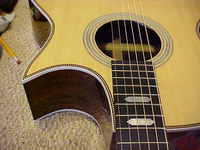

Prebend the herringbone to fit. Piece of cake.

Bruce, that does look good, bud!
PostPosted: Wed Jun 06, 2007 3:57 pm
Nah, that's the best pic I have of the horn. I can tell you it wasn't a problem and interleaved nicely.
Miters, no matter the angle, are simply a connection of the inner and outer cross of any two intersecting lines.
The butt of the guitar is similar, equal parts on each side.
Hint. Do the Florentine first, then the butt joint at the tail. The joint under the fingerboard will not be seen, as in this pic.
